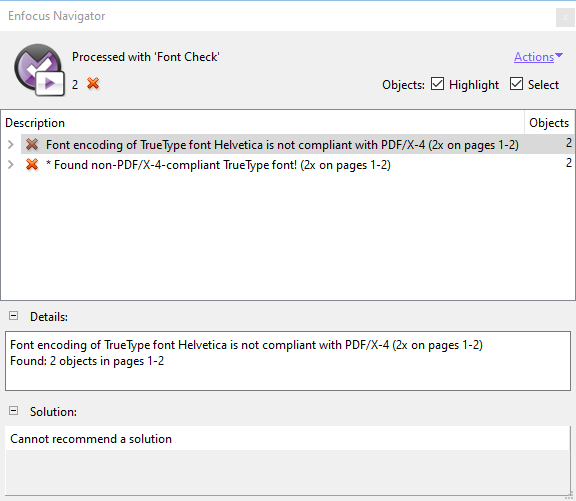

my preflight reports that the PDF contains TrueType fonts that do not comply with the PDF/X-4 standard.
What action can I take to make these TrueType fonts compatible with the PDF/X-4 standard?
TTF not PDF-X-4-compliant.png (18.45 KiB) Viewed 47160 times

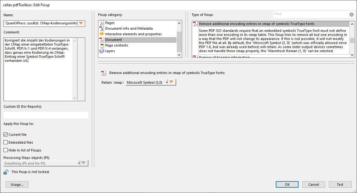

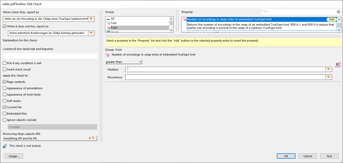

the PDFToolbox from Callas offers a fixup “Remove additional encoding entries in cmap of symbolic TrueType fonts”. This corrects the PDF.
There is also a test that can be carried out in advance.
2025-01-29 08_25_00-callas pdfToolbox_ Edit Check.png (32.74 KiB) Viewed 47035 times
callas pdfToolbox_ Edit Fixup.png (35.28 KiB) Viewed 47036 times
