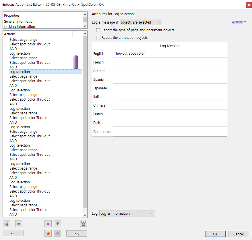

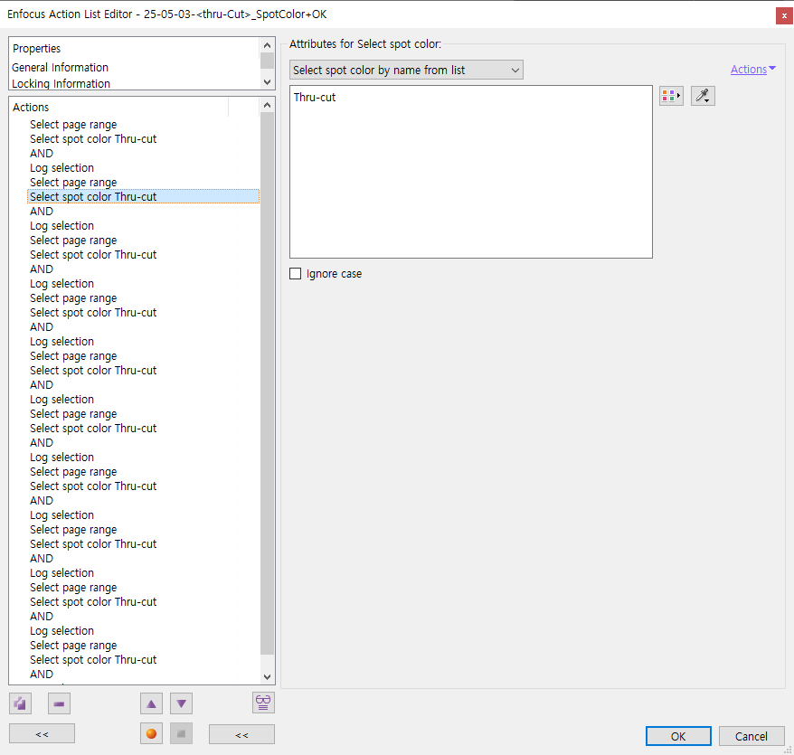

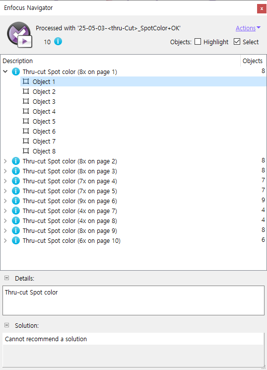

I want to detect and count a specific object spot color( "cut") in each page.
Can I make a report or an action so I can find out how many object colors "cut" are on each page?
example:
found: 27 objects spot color "cut" on page 1
found: 24 objects spot color "cut" on page 2
found: 12 objects spot color "cut" on page 3

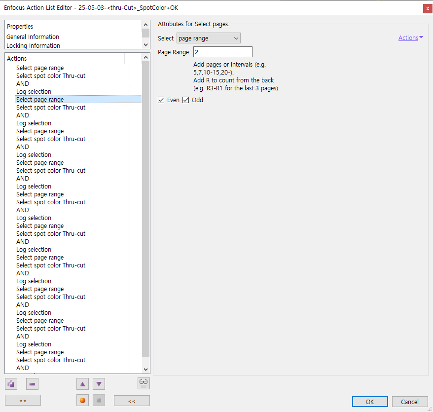

It's not bad....works.
You just need to add a 'page range' in the action equal to the number of pages in the document,
or add more than the total number of pages.
Thank you!
