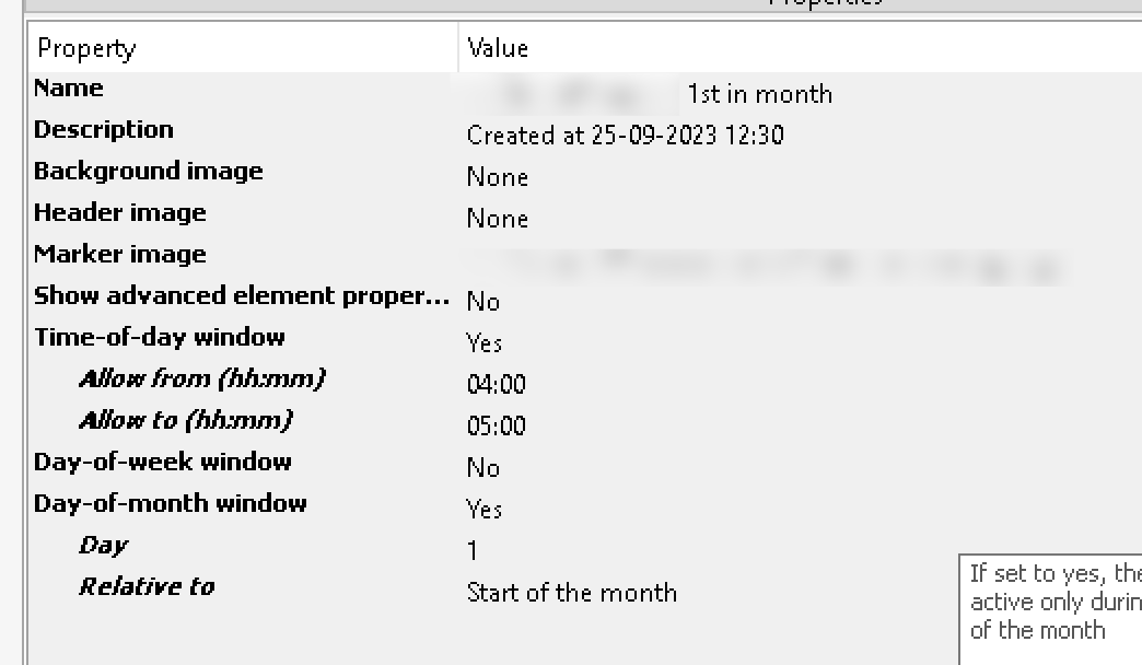

I have a flow where I want to trigger one dummy job the 1th each month at 8 AM. Any ideas how to achieve this?

I would setup a flow like below.
In my case it checks an ftp for files.
But if you setup Firestarter or other app to output a file every 2 hour, then you should end up with just one dummy job in the timespan the flow has.
Royal TSX-Flow-server03-2025-05-20 at 10.28.17@2x.png (36.84 KiB) Viewed 5804 times

A dedicated app for this would be nice, like "trigger cron job" with cron notations as a parameter.
Right now I would solve your use case with the app "FireStarter" from the app store:
https://www0.enfocus.com/en/appstore/pr ... irestarter

It could easily be done with a script

Thanks I never used this property on a flow before, works great!
