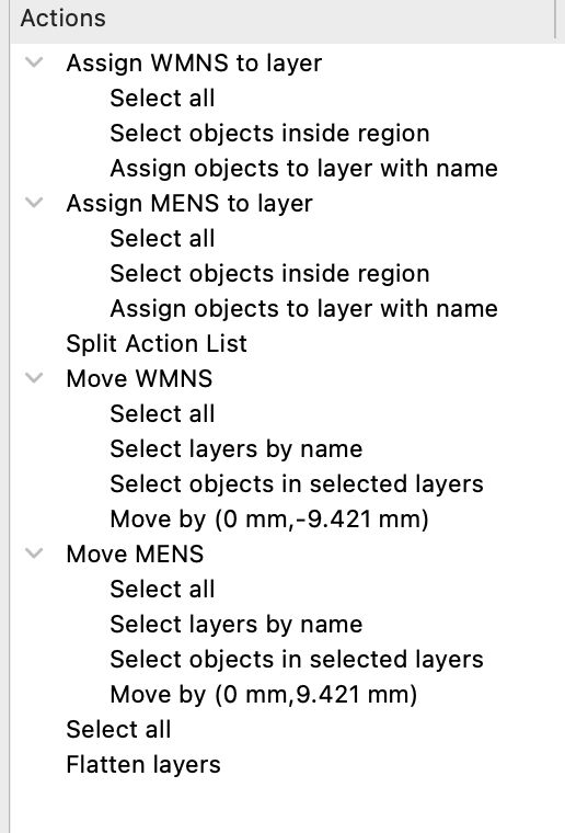

Here is an action list.
https://github.com/jimmyhartington/pits ... blocks.eal
I decided to assign the objects to layers named WMNS and MENS. And then used this to select the items afterwards.
They are selected by region, so please test on a bigger sample to see if this file was representative of the entire batch.
This could probably also be done by copying and pasting.
CleanShot-CleanShot-2025-05-27 at 12.04.40@2x.jpg (60.67 KiB) Viewed 6047 times
