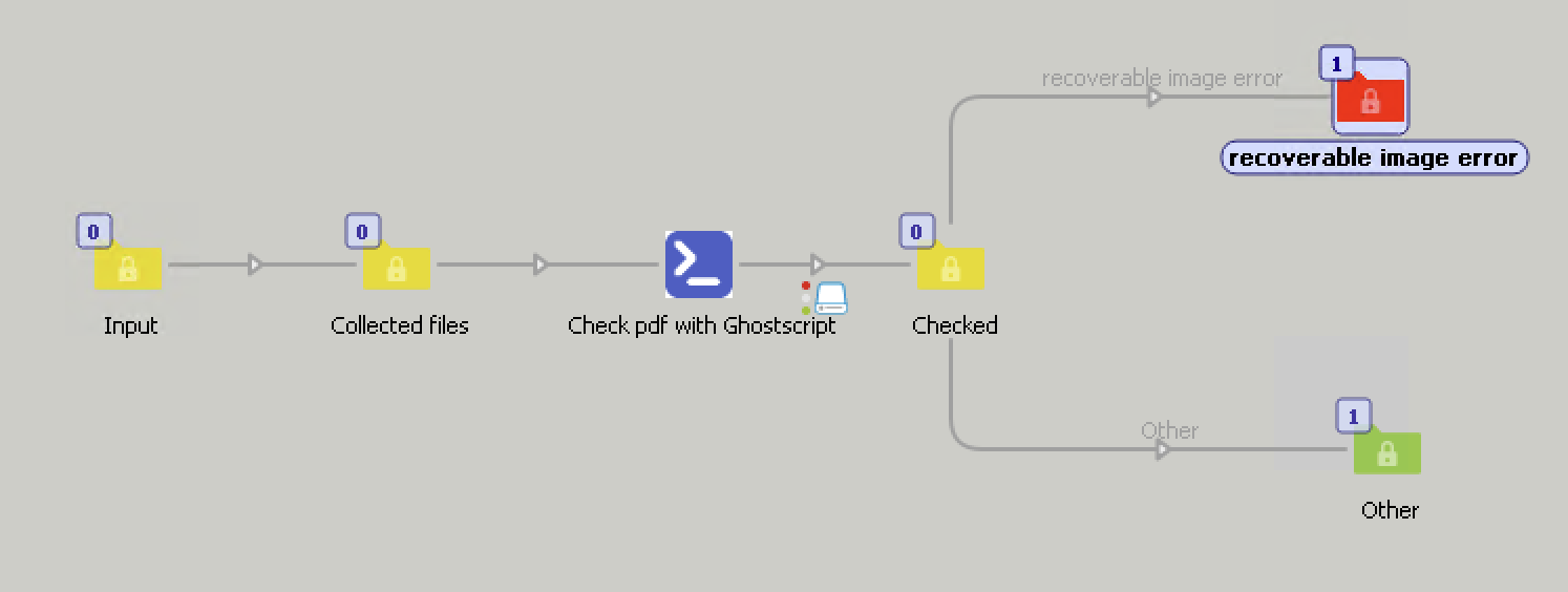

I have made a sample flow for Switch, which sort your sample file in one direction and files without the "recoverable image error" another direction.
You can show this to your Switch administrator.
The sample flow uses the Run Command app and is running on a Windows server. If your enviroment is macOS, then the command in Run Command should be adjusted accordingly.
