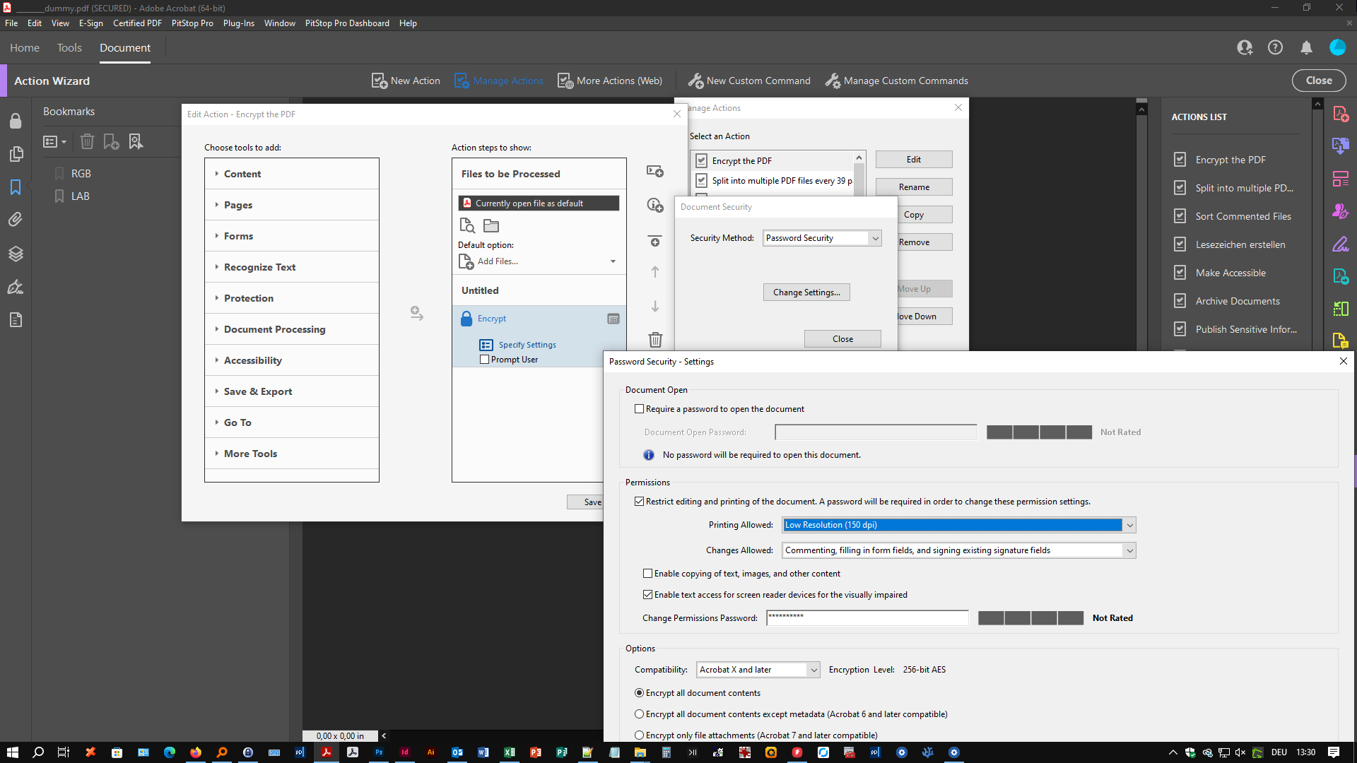

As an alternative to a PitStop action list, you could do this directly with Acrobat's own Action Wizard tool and a custom Acrobat action. The screenshot shows how.

yosimo wrote: Wed Oct 01, 2025 1:48 pm
schmitzdp wrote: Fri Jul 11, 2025 1:05 pm ...I would have preferred to use Pitstop...
Is there a way to adapt it for Pitstop Server ? (Whether to lock it or certify it)
