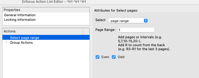

i need that the "page range", works on the all group.
attached file.

Re: use "not" to a group action
Ok, I understand now better the construction of the group itself
Have a look at this:
if the "color" pages will vary, the best option is to use Smart Variables in the select pages by range Action.
Then anytime you run the Action, PitStop will ask you to set the Range. You won't need to change Action itself.
Loic

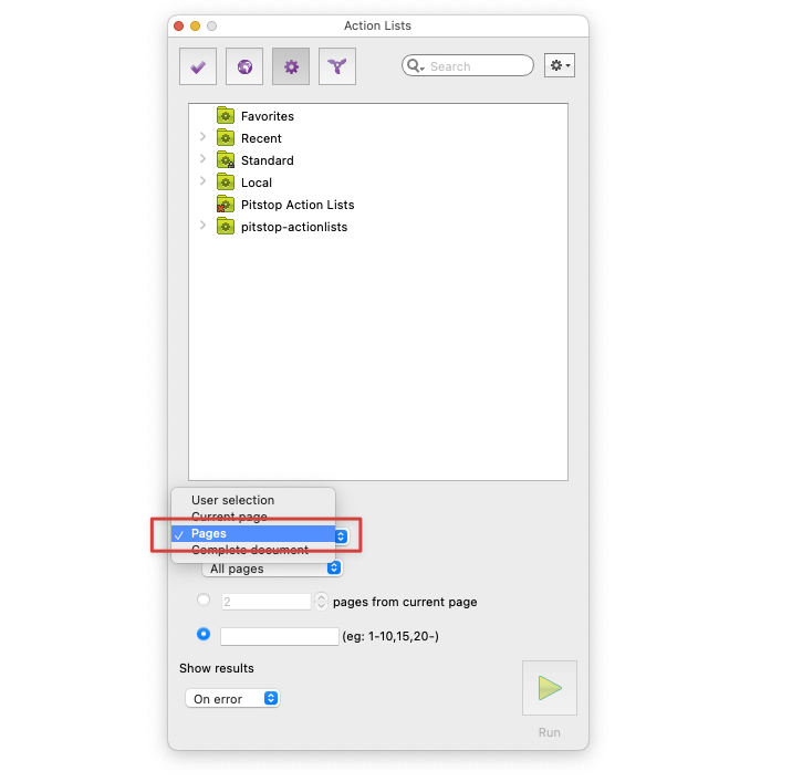

Or use the page range in the Action Lists panel, when running the action.
Then the action can just use select all.
