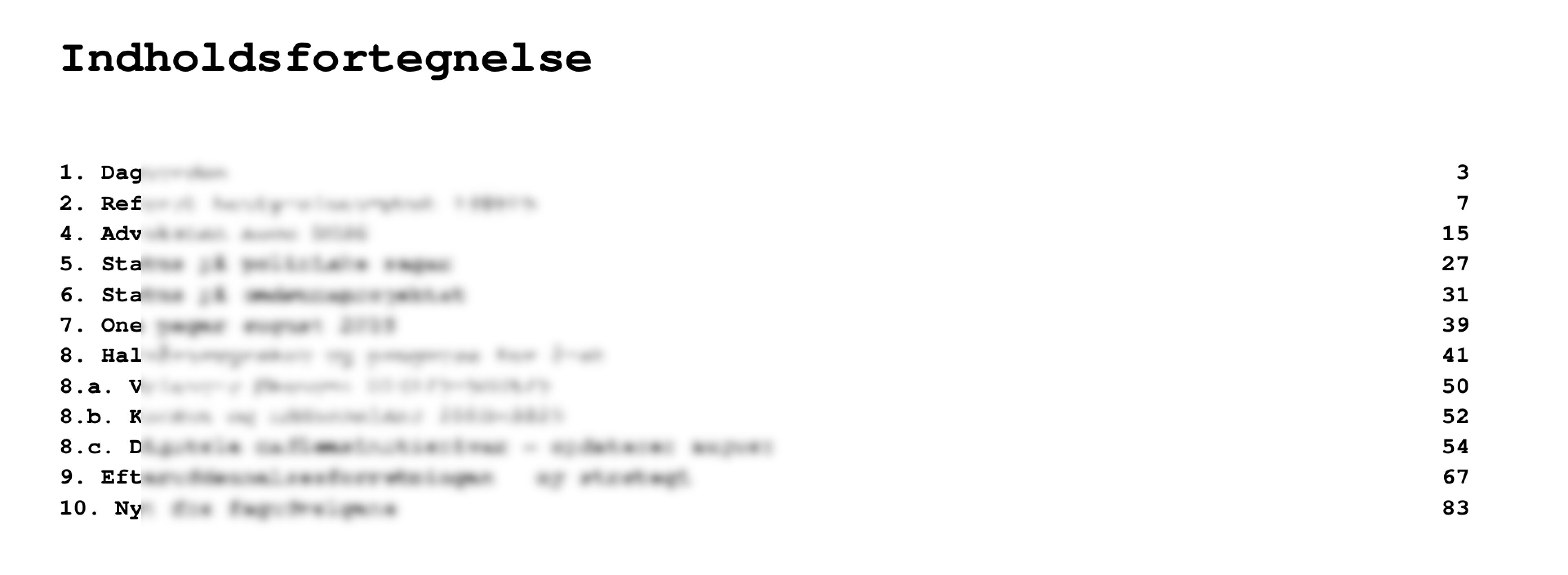

I use the command line tool cpdf from Coherent PDF (https://www.coherentpdf.com) to do this.
The incoming pdf has bookmarks. I run this command with the Run Command app:
"C:\Program Files (x86)\Coherent Graphics\Cpdflib 2.7\cpdf.exe" -table-of-contents -toc-title "Indholdsfortegnelse" -font "Courier-Bold" %%InputFilePath%% -o [Job.NameProper].pdf
And it gives me a TOC like this where the entries are also links to the pages:
Royal TSX-Flow-server03-2025-08-20 at 07.33.15@2x.jpg (108.89 KiB) Viewed 18683 times
