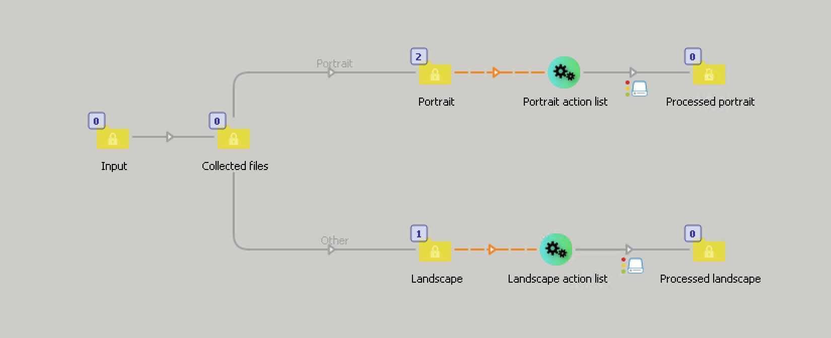

For a simple solution I would sort the files to in a Portrait and Landscape folder and then have a Pitstop configurator to run the action list corresponding to the orientation.
Like this:
Royal TSX-Flow-server03-2025-08-22 at 13.37.49@2x.jpg (36.85 KiB) Viewed 16775 times

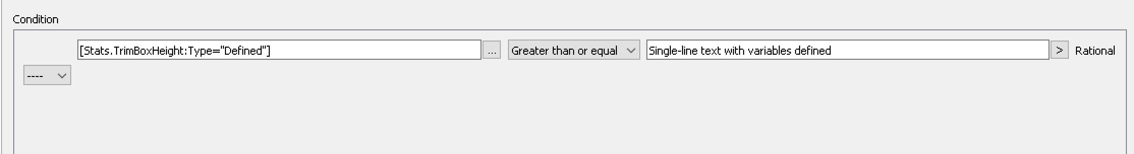

The trick is the connection from Collected files called Portrait has this condition:
Royal TSX-Flow-server03-2025-08-22 at 13.24.10@2x.jpg (28.92 KiB) Viewed 16777 times
The variable in Greater than or equal is Trim Box Width. This assures that Portrait and Square ends up in this folder.
The other connection is just set to other.
Other ways to do this is having one action list which selects a page based on the orientation and the has the correct changes after this selection.
Or a Pitstop Profile with 2 action lists inside where orientation triggers one or the other.
But if you are new to Switch I think this way is conceptually simple to understand.
