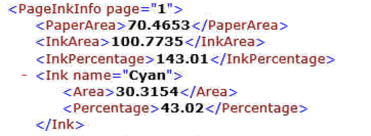

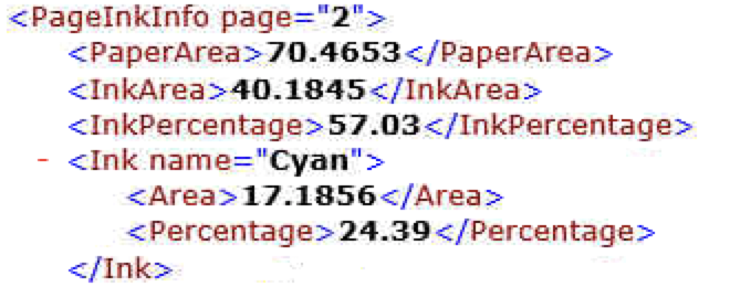

I'm trying to build a flow that sorts a 2 page pdf so the page with less ink coverage is ordered first. I have a preflight check with pitstop server configured to output job data with an xml log. I assume I just need to map this snippet of xml to variables (Page 1 ink percentage = 143.01, Page 2 Ink percentage = 57.03) so I can configure a routing connection. How can I go about doing this?

I can think of a couple of ways to do this. Do you have the scripting module for Switch?

Yes, I do have a trial of the scripting module
