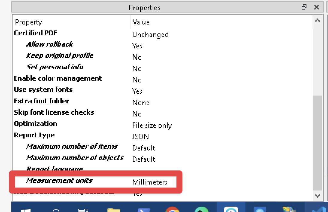

Have you set the units to Milimeters in the Pitstop Server Configurator?
Royal TSX-Flow-server03-2025-10-20 at 15.14.16@2x.jpg (68.96 KiB) Viewed 920390 times
Robbie
Posts: 150
Re: Strange thing happening in my flow with grummets
Post by Robbie »
Yes everything is in mm. but still it puts the grummets on the wrong space. I put in 300 mm between the grummets but he places them round 150mm (see exemple)

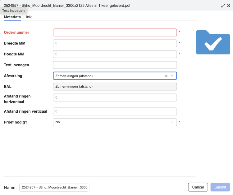

Your action list uses the variables [Afstand ringen 10% horizontaal] and [Afstand ringen 10% vertikaal]. How is that variable defined and where does the value for that variable come from (metadata, private data, file name, database, ...)?
Robbie
Posts: 150
Post by Robbie »
That is metadata coming from manual imput in switch

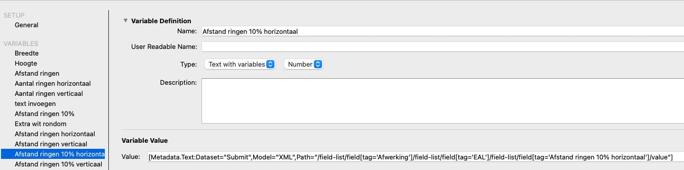

Scherm­afbeelding 2025-10-21 om 10.23.46.png (51.82 KiB) Viewed 920332 times
Posts: 1189
You only answered the second part of my question.
What is the definition of the variable in the variable set?
Robbie
Posts: 150
Post by Robbie »
This you mean?
Scherm­afbeelding 2025-10-21 om 14.11.06.png (59.02 KiB) Viewed 920312 times
Posts: 1189
This is what I meant.
This cannot be correct because this variable must be a "Length" and not a "Number". When choosing "Length" you will also see that you can choose the units of the value that you pick up from the Metadata, in your case "Millimeters" of course.
