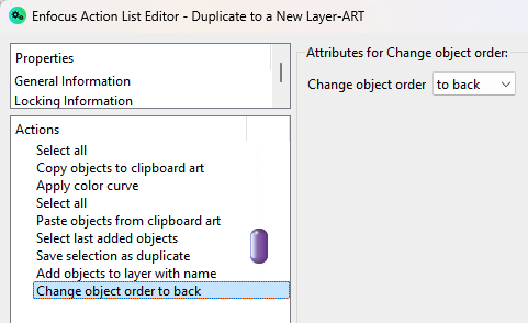

My process was to (see screenshot):
Select All
Copy
then after I copied the art, apply the color curve
now paste the original art back and add it to a layer
then send the original art to the back
so after this I would select all art that was not in the layer and run the trace on it.
But I always end up with the 5% curved artwork instead of my original artwork.
Honestly it's quite a mess.
Is there a way to make my method work? Or is there a better way?

- Screenshot 2026-02-05 at 9.42.11 PM.png (26.08 KiB) Viewed 9984 times

You need a second version of the file contents that can be modified and afterwards discarded. Here is a strategy to do that.
Select all
Copy
Select all //this one is important before pasting
Paste
Select last added objects
Assign objects to layer with name, e.g. TEMP
//Now you have a copy in a separate layer
Select objects in layer with name TEMP
//do what you have to do to create the varnish, you already have that
Assign objects to layer with name Varnish
//clean up
Remove selection
Select all
Remove empty layers
Select all
Copy
Paste
//clean up
Remove selection
Select all
Remove empty layers
Re: How to duplicate layers in PitStop Server?
It worked like a charm, thanks much.
So that second Select All added before pasting - what exactly is that doing?
Good question. It is VERY important to realize that an action only does something if the selected objects are meaningful for that action.
Select images
Outline text
It is easy to understand that this does not do anything. If you do
Select images
Copy
Paste
that does not do anything either, because you cannot paste onto images. Paste works on a page and "Select all" will select the page object ("Select pages" will also work of course).
Similarly,
Select text
Outline text
Change trim box
will outline the text, but it will not change the trim box because text does not have a trim box, a page has.
Ok now I see. That makes things way more clear.
It even gives me an idea of where I went wrong with some of my previous actions.
Thanks again for your help.
