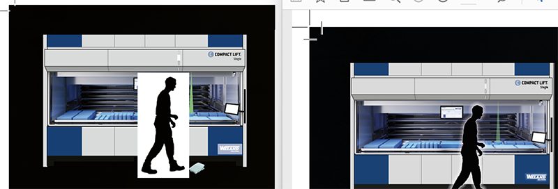

Unfortunatly the action list also seems to remove transparency settings that are required:
Example-file: https://tinyurl.com/3fzdmefn

Hi Magnus,
After looking at it, I think that one possible adjustment is to discard pages that actually contains transparent objects. That way you only consider pages without transparent objects when removing the Transparency Group Settings.
If I run on your file, I don't see the problem you did report anymore.
Can you have a look?
