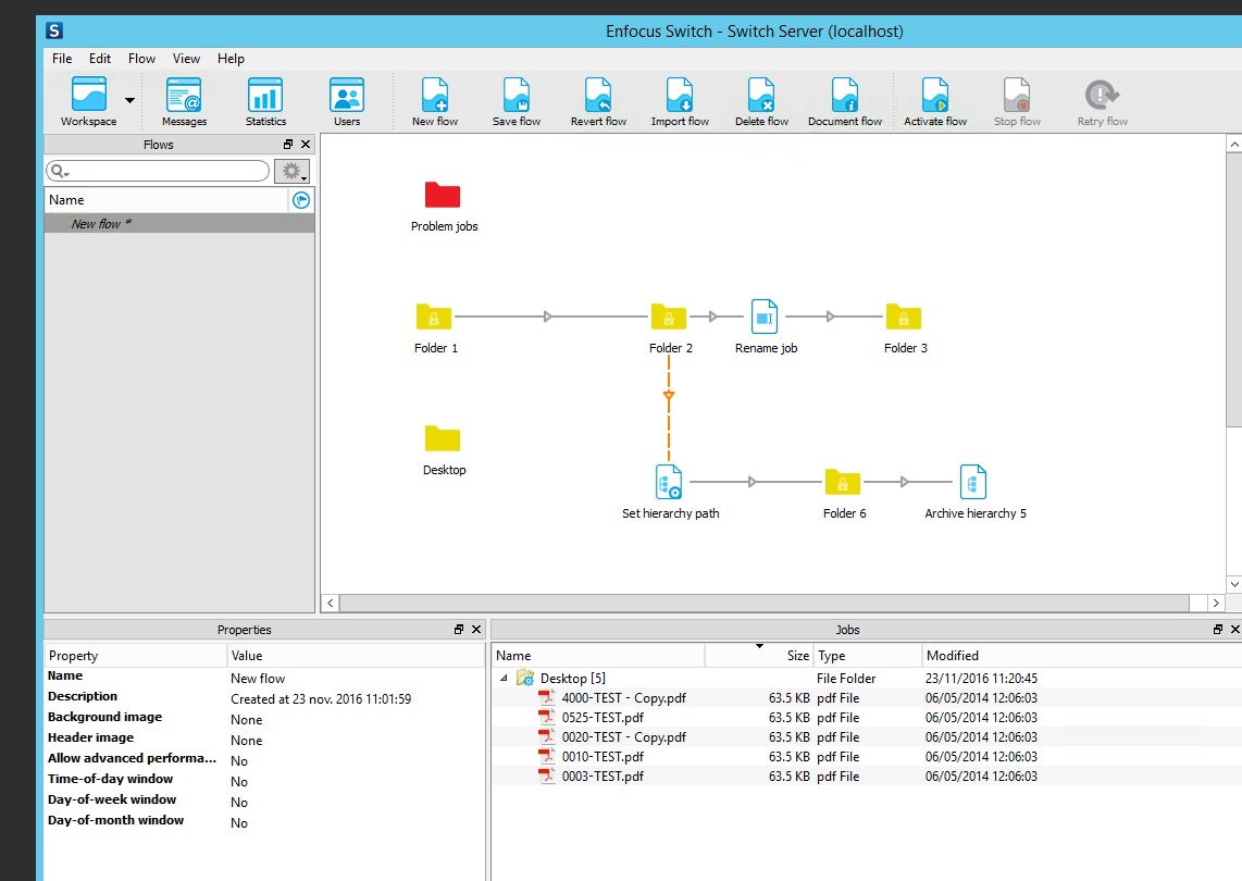

Hi all,
I have a request.
I must use a path to archive my pdf, and my path is like this always on 4 digit.
Today we work with 0153 all is OK. but now i must change this and use only 153, without the "0".
In my example on the attachment i want to create folder with :
4000 (folder)
--------4000.pdf
525 (folder)
--------0525.pdf
20 (folder)
--------0020.pdf
10 (folder)
--------0010.pdf
3 (folder)
--------0003.pdf
I try to test some different way to do this but i don't found the solution. I can rename with a exep with search and replace but the tool "Set Hierarchy path" can't work with the same because don't have the "search and replace".
Any idea to help me ?
Thanks.

Define the hierarchy path as [Job.NameProper:Before="-",Search="[^0]\d*"]
Meaning: take the part before the hyphen and in that part search for the first non-zero character followed by zero or more digits. So for 4000, the non-zero matches the 4 and all that follows, for 525 it matches the first 5 and all that follows, etc.
Posts: 1189
Re: Remove 000 from my Heriarchy Path
I meant: for 0525 it matches the first 5 ...

Thank you freddyp it work perfectly :-)
