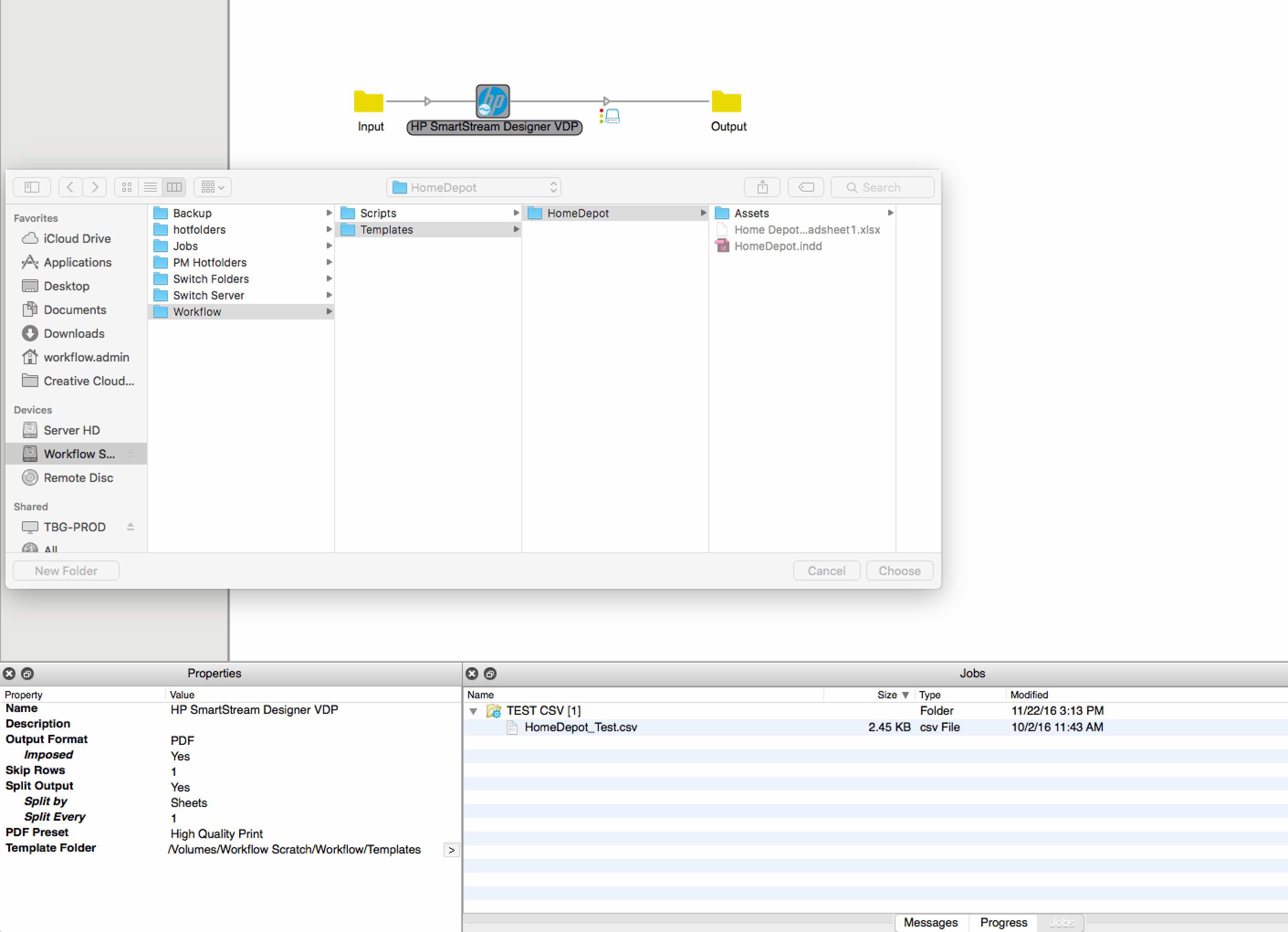

My configurator is setup to go to the root of the Templates folder. Inside I have a folder called HomeDepot. My Indesign Template is called HomeDepot.indd. My CSV file is called HomeDepot_Test.csv ( I have tried renaming to just "HomeDepot.csv") Always with the same results, drop the file, it launches InDesign and nothing happens. I don't receive any error from SWITCH it just doesn't do anything.

I figured out where my problem was. I had my templates folder on an external raid attached to the computer using it as a scratch disk. As soon as I pointed my templates folder to the local drive the configurator works as normal.

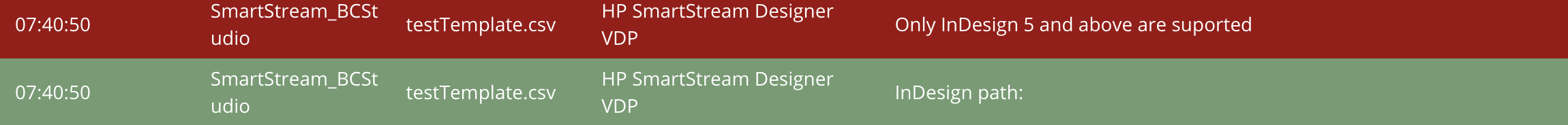

did you solve the problem? I am currently having the same problem after reinstalling our switch server. Running SmartStream Designer VDP I get the error message: 'Only InDesign 5 and above are suported'
I also get a debugging info with an empty Indesign path.
My Windows Server 2019 System runs Switch Spring 2021, Adobe Indesign 16.4, HP SmartStream Designer 16.0.8; Extendscript Toolkit CC
Do I have to assign the indesign path for SmartStream Designer VDP separately at any point? Any ideas?
Thanks, Thomas

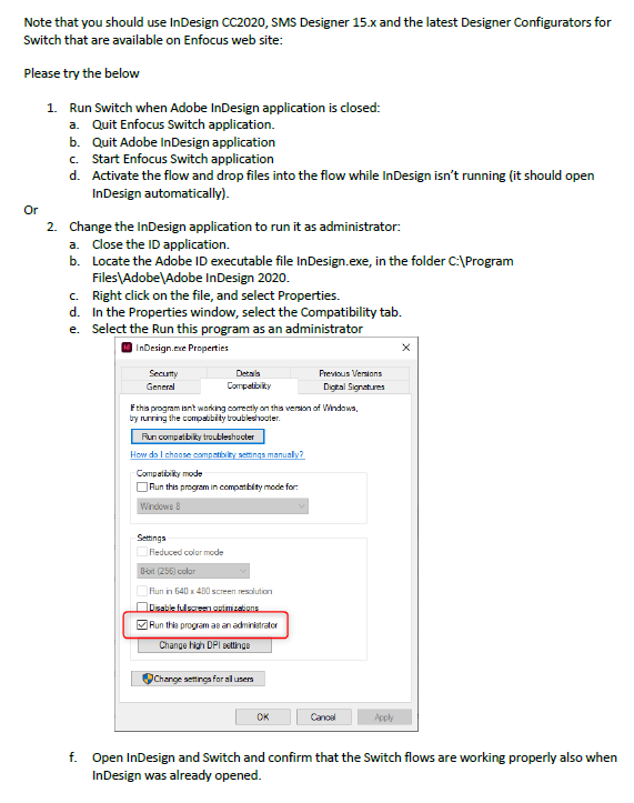

It was a while ago that I had the issue and I have not used the Smartstream VDP plugin for a while but I found upgrading to Indesign 16.0 fixed my issue. I would suggest to make sure that you don't have any other versions of indesign installed on the server and that you have the latest configurators.
This is what I received from HP, but to be honest this didn't fix my issues at the time.
