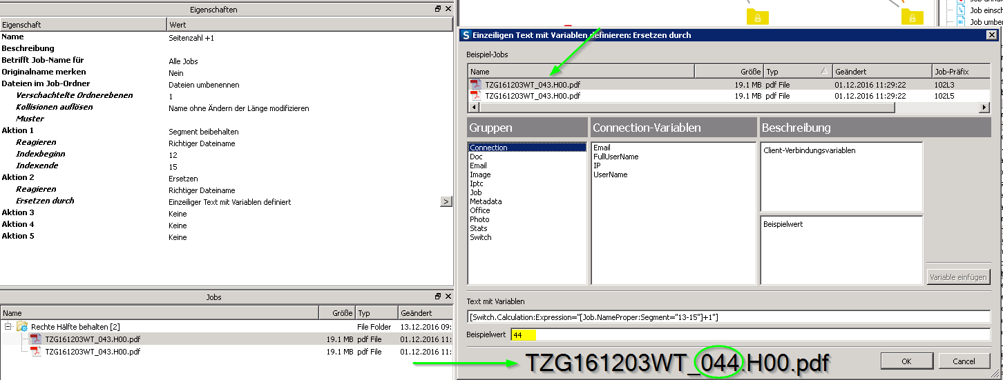

I have to increment the filename of PDF-Files. The Three-digit number of pages at 13th to 15th place must be incremented by one (+1).
When I use the enclosed Script (Screenshot), there is only the pure page number left.
How can I get the whole name and only count the number?
Any Idea? Thanks a lot in advance!
Original filename:
TZG161203WT_043.H00.pdf
Expected filename:
TZG161203WT_044.H00.pdf

Re: Switch: Increment filename (number of page) +1
