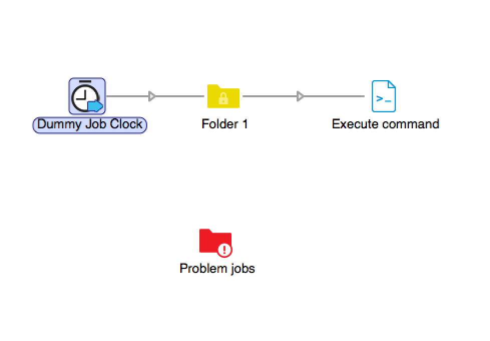

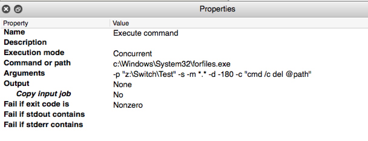

I made you quick thing and tested it, to give you an idea.
There might be easier/better way but this should work.

I like this solution Zoran!
It is another very nice example of the use of an external tool (in this case a Windows command, but it could be anything else), but under the control of Switch to determine when and how the external tool should be run.
