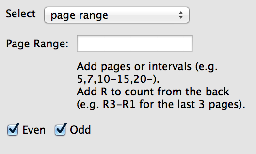

You have been using the calculation as the name of the variable set. That is not going to work. You have to select an existing variable set, or create one, both through "Select variable set", edit or create a variable set, add a variable, define the value of the variable with your calculation, and use that variable in a preflight profile.
That is the hard way.
This is the easy way:
Screen Shot 2017-03-23 at 9.20.52.png (35.96 KiB) Viewed 11935 times
The screenshot is bigger than in the Action List editor UI so you can read it better :)

We're running Pitstop Pro 13, but don't seem to have the option to assign page range using the 'R_' id.
Is that specific to a newer version, or are we missing something?
Thank you for your help.
Posts: 1186
Re: Targeting 2nd to last page
This was added in PitStop 13 update 1.
