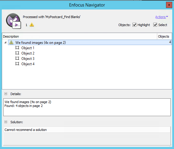

I'm looking to extract the description of a warning report generated from running a Pitstop Action. I am using a Pitstop Action List to to check for how many instances a specific object/image is found within a PDF file. Then I need to utilize the number of instances within Switch to run a Switch.Calculation. Attached is the report generated from the action check, which shows that it has found the object/image 4 times.
Anybody know how I might go about getting to this data within Switch?

I have figured out how to access the string from the Pitstop warning within Switch -- the Pitstop report needs to be changed to XML versus the default which is PDF.
