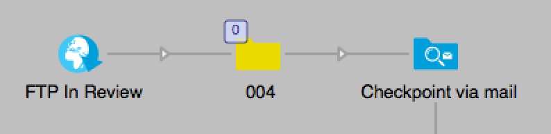

Why does this :

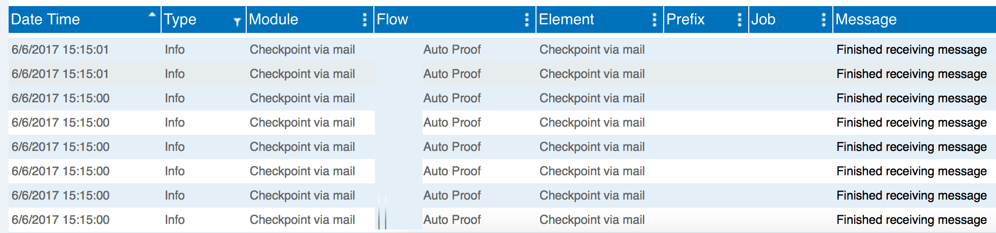

Cause this :
Screen Shot 2017-06-06 at 15.17.55.png (154.31 KiB) Viewed 6013 times
It goes into overdrive and reports that it is receiving over and over even when there is nothing in the preceding folder :o

The logs talk about a "message" instead of a "job", so I think they are related to "mail messages" on the email address monitored by Checkpoint via mail instead of Switch jobs.
Are there mails in that mailbox which have nothing to do with Checkpoint via mail?

Yes! That is exactly it :!:
There are many emails in the Account that Switch is routinely checking on, and as such it has to look over each and every email to make sure that none of them contain the key Job No. or Action that it is searching for in the Flow.
I've cleared out all the obsolete garbage from the Inbox and hopefully this should calm things down.
