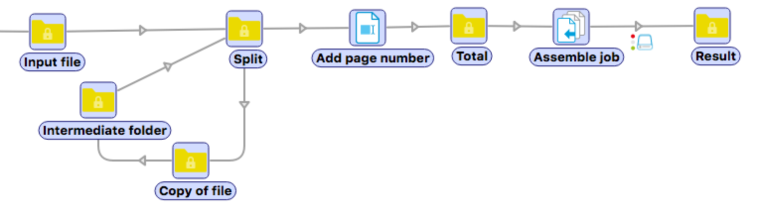

Impressive Sander, but how about this solution? ;)
Screen Shot 2017-06-23 at 13.48.48.png (55.18 KiB) Viewed 23711 times
Both your and my solution duplicate pages like this 1234,1234,1234, but perhaps it has to be 111,222,333,444 or still something else? The apps handle it all and in a much simpler way.

Well, like I said it's one of my first Switch touches, now I'm wondering why I'm injecting and deleting haha, should rework it once :) It can be done better but hey, if it ain't broken.. ;)
It's not really only duplicating, it is a sheet filler and one card becomes the orderform via PitStop, one of the arrows hold some logic to check if the sheet is filled to move along.
