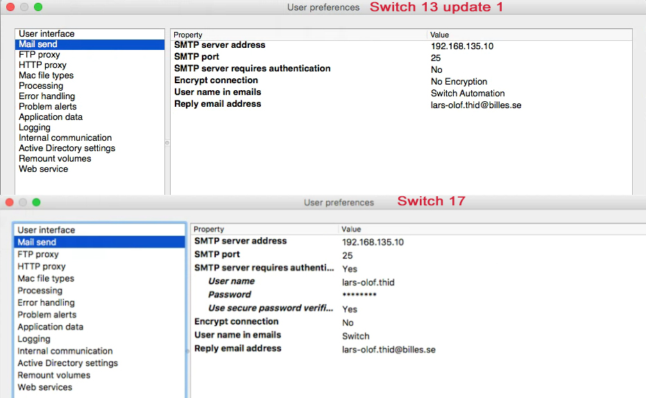

Re: Switch 13u1 mail settings in Preferences
Ahhhhhhh....
You have just to love computer logic.....
For two days I've been scratching my head trying to figure out why on earth the developer server is sending mails while the production server wont send mail with the same settings.
Just out of the blue a thought popped up in my head, what if I set SMTP server requires authentication to No?
Yup... the fricken server starts sending e-mails like crazy......
Now I just need to figure our what Client Authentication error. Incorrect Password means......

Haha lol, good to hear man!
So your developer server needs authentication and your production server not.
At least that's strange
Explain this if you can...
- Switch.jpg (252.77 KiB) Viewed 19418 times
