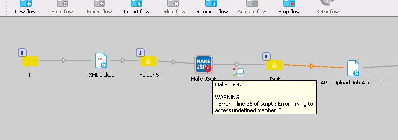

Hi Jan,
I'm getting an error on the new app which is showing a "red cog" as well.
I'm trying the same code as earlier (have tried others as well) and getting a warning "Error in line 36 of script : Error. Trying to access undefined member '0'" (screen shot attached)
Is this something in the app at all?
Cheers,
Cade
json error.JPG (30.67 KiB) Viewed 22188 times
jan_suhr
Posts: 709
Location: Nyköping, Sweden
Re: Using variables in script to create Json - Newbie help
Post by jan_suhr »
Can you send me the JSON you are trying with.
I did try the one you posted earlier without any variables and it did work as is, viewtopic.php?f=13&t=2056#p7200
Jan

jan_suhr
Posts: 709
Post by jan_suhr »
Well it seems that if you only have one variable from Switch the App will fail, if you have more than one variable it works.
I'm working on a fix.
