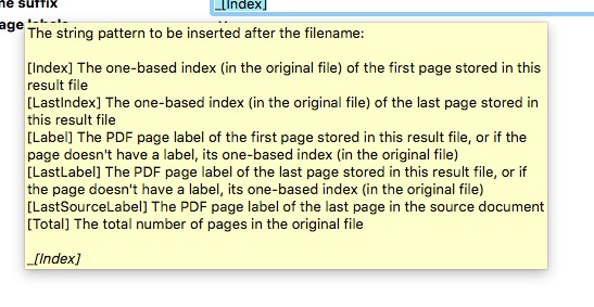

You can construct what you want by using the different suffixes or prefixes in the SplitPDF element.
Screenshot 2018-02-21 23.00.16.jpg (70.61 KiB) Viewed 6016 times

jstotz
Posts: 17
Joined: Thu Jan 22, 2015 7:47 pm
Re: Padding the suffix in the split element
Post by jstotz »
Thanks, but that doesn't do what I want. I'm already using the [index] as a suffix but I want to modify it by padding it to 3 digits using the javascript padstart method.
