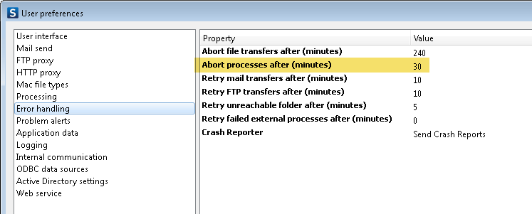

Take a look at your preferences and make sure you are not timing out after x minutes.

beastridge wrote:Take a look at your preferences and make sure you are not timing out after x minutes.
Thanks beastridge! The time out is set to 20 minutes, so I guess I'll either have to increase that value or try the solution suggested by Jan.
