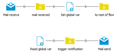

This would require two scripts.
sample flow.png (12.44 KiB) Viewed 4904 times
The first script should set a variable (flag) in the global-data of Switch. This flag gets set when a mail is received.
See topic "Maintaining global data" under "Scripting reference/Flow element module/Environment class" in the scripting manual.
The second script, which is timer-fired, has two tasks:
1) Reset the flag is time is before 5:00
2) Create a dummy-file as trigger if time is after 10:00 AND the flag is not set by the first script.
If you want it should even be possible to combine the two scripts into one, but i think this example is more straight forward.
