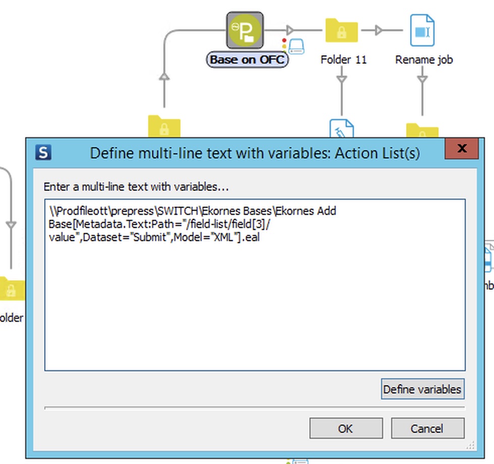

I just updated PitStop Server from 2017 to 2018 and I ran into a couple of problems with the new configurators.
How can I use Multi-line text with variables defined to call for an action list?
With PitStop Server 2017 I just needed to add the path to the action list before the action list name, but for some reason that doesn't work.
I tried to import the action lists to PitStop Server 2018 and then just added the name of the action list, but that doesn't work either.
The error I get is Dynamic property 'ActionList' has invalid value 'Name of the action list'
I have several flows where I have used this way of using action lists, so I'm in dire need of a solution.

You have to put path, I remember running into same issue, see screenshot how I am using it now to add different base to PDF using Pitstop server
Screen Shot 2018-09-07 at 1.20.38 PM.jpg (134.13 KiB) Viewed 10248 times

Thanks Zoran, your screenshot pointed me in the right direction...
It turns out that for some reason Enfocus has changed the way PitStop Server reads the paths between PitStop Server 2017 and PitStop Server 2018.
With PSS 2017 you could set the path to /Users/username/..., but with PSS 2018 you have to have two / at the beginning of the path, ie. //Users/username...
God knows why they change a thing like that without letting people know... :twisted:
Also I added all of the action lists I had previously selected with Select from library to PitStop Server and then selected them via Select many from library.
