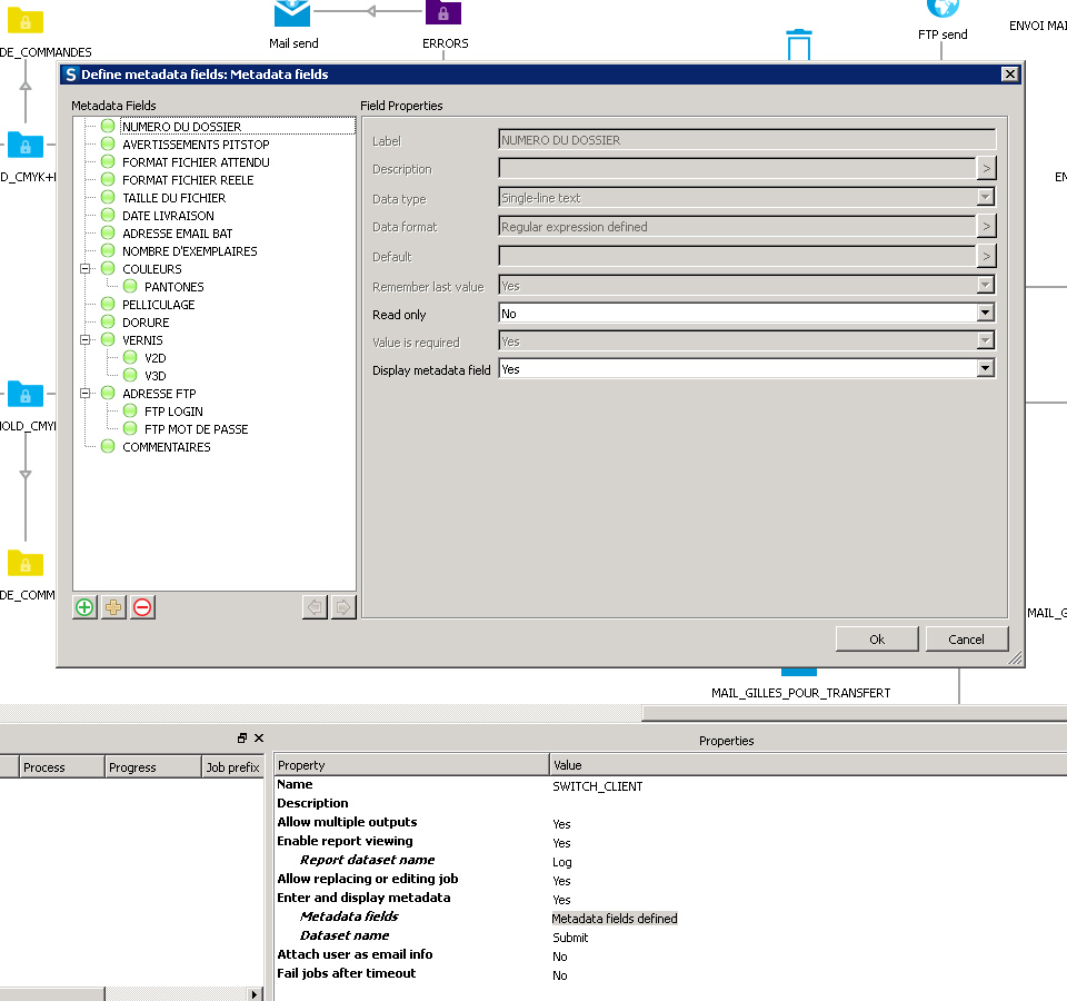

Picture 1317 is the submit point dataset name Submit.

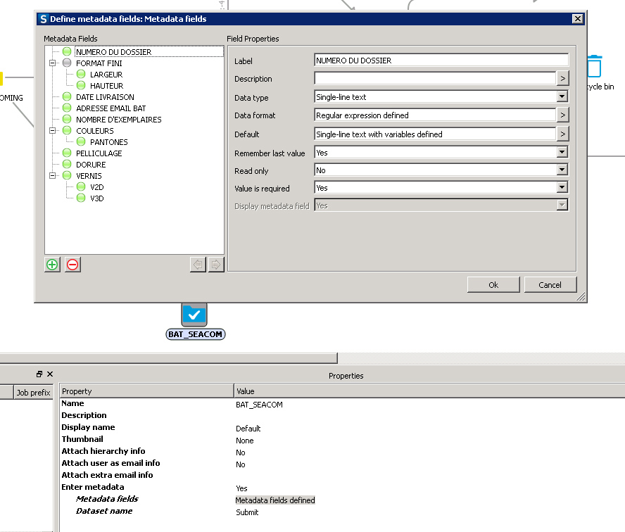

Picture 1318 is the check point dataset name Submit

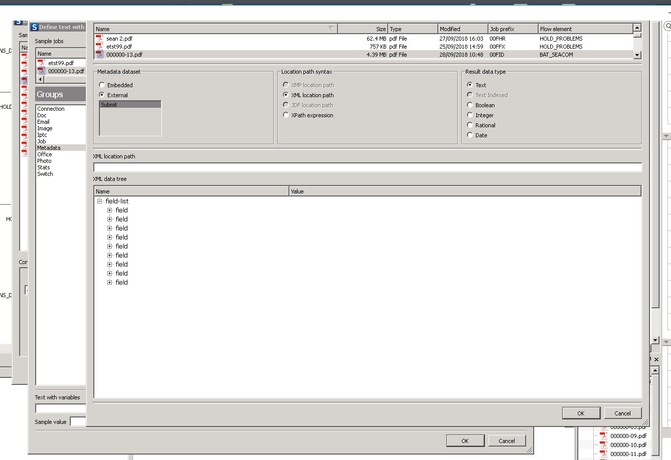

Picture 1319 is two steps after the check point and I can only see the fields from the original submit point and not what was added or changed at the check point.

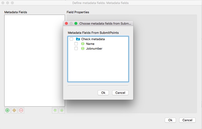

When you create your check points metadata fields you have a yellow "PLUS" button. This only works if the dataset names are the same.
When you click the plus-button you can select the fields from the submit point and add them to the check point. Then you get all information in the dataset after the check point.

Well it's now working.
FWIW, I was using the link between a folder and, in this case, "send by FTP" and I wasn't seeing the "Check" metadata in order to hold jobs or not.
By selecting the "send by FTP" icon and building the path I can now see the "Check" metadata in the little box under the embedded or external dataset.
It keeps the field names from Submit and adds those from Check.
The path reads "[Metadata.Text:Path="/field-list/field[13]/value",Dataset="Check",Model="XML"]"
