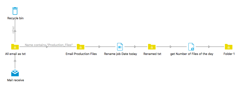

  • Receive the email as .txt and use a script to process its information to determine the total number of expected .pdf files. It should be easy to get the names of the files instead, if we’d have to. (view attachment: mail-receive-process.png)

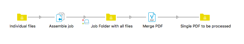

  • Having a fixed number of files, use the Assemble Job configurator to assemble the .pdf files into a Job Folder, and then using the Merge configurator to join them into one. (view attachment: assemble-merge.png)
What we’re missing is the bridge between the two parts, that is, dynamically defining the number (or the name) of files that should be assembled into a Job Folder.

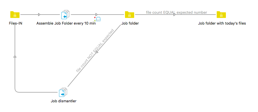

  • Make a loop which receives the .pdf files and does Assemble Job and Disassemble Job until the total number of files in the Assembled job is equal to the number in the Counter.
 (view attachment: assemble-loop.png)
    Result: The Counter seems unreliable, as it seems to keep incrementing with no reason. We tried using brand new counters and running the script only once, and even activate the flow once without deactivating, and placing the exact number of files as the counter all at once, and it still failed.
Despite that, this option doesn’t seem to be practical or efficient, being as it processes files several times without real need for it.
