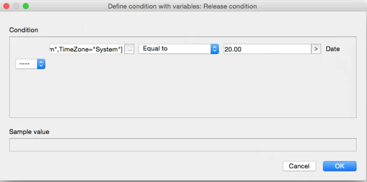

I have added a Hold job, set Delay scheme to Release condition. If I then select Define condition with variables I can choose Switch - Date which will give me the current date and time including milliseconds, but what do I enter in the Format box?
I tried putting hh.mm and setting Time zone to System, but when I click Insert variable and then OK it seems to expect a date and not a time...

You have to add the date as well. Otherwise it will not now which day at 8 o'clock it should release the file.
Try this: [Switch.Date:Format="yyyy-MM-dd",TimeZone="System"]:20:00

Yes I understand but for Switch to understand the time it shall release the files you have to have a date in the field too.
With the variable you will get the date of today, then manually add the time in the correct format like this, I didn't write it correctly in my last post
T20:00:00
The seconds should be there too.
Then it would release the file every day at 20.00

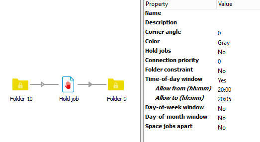

Wouldn't it be easier to use a Hold-job with a time-of-day window on the outgoing connection?
- screenshot.50.png (7.37 KiB) Viewed 11253 times
