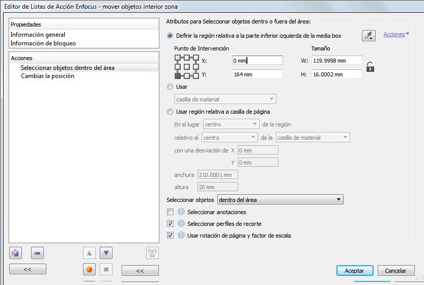

I have a little problem with an action list I have created.
It simply move the content of a zone the mm defined by the user via distance X e Y variables.
But I can't use variables in the X, Y, W and H fields of "Define zone relative to...".
I have tried to define variables like length or numeric without result.
I know you can only use variables at fields that match the type Pitstop is waiting for, but I don't understand why I can use it in X and Y distance values, but not in X and Y offset values in zone definition.

The second step, with variables in X and Y fields...
