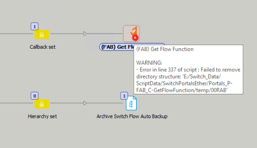

I've been trying to get this Auto Backup Flow to work however I have hit a bit of a snag. I am getting a script error on the Get Flow Function portal in the Auto Backup Program flow. Have you seen this error before?
Thanks
Dave
gabrielp
Posts: 645
Location: Boston
Re: Flow Auto Backup
Post by gabrielp »
Hey Dave,
Try remaking the portals with the latest version of the scripts or the Portals app from the app store. It may be a bit tedious but if you bring in new configurators and configure them manually you can be sure that nothing is corrupt. I bet one problem is that the versions of the Portals script in the example flows are very old.
You can grab the latest scripts from here https://github.com/open-automation/switch-portals and the app version from the appstore here https://www.enfocus.com/en/appstore/product/portals
Let me know if that works out.

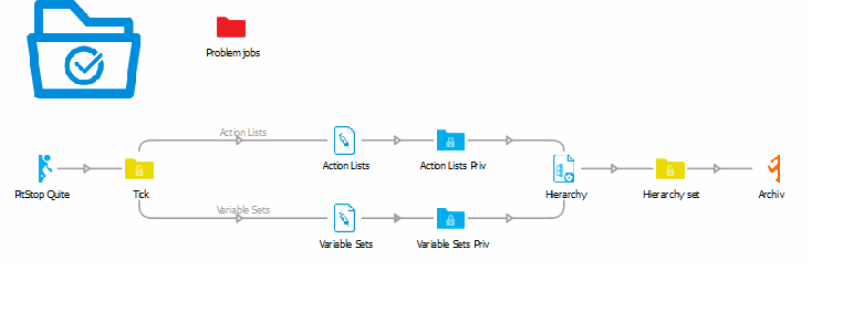

Thank you for this Flow Auto Backup, I added it to my Flows.
Also I expanded it a bit. Thought it could be useful to backup the ActionLists and Variable Sets as well.
Just route the Trigger to another flow. Use the tool to pick up jobs for example C:/Users/Druckserver/AppData/Roaming/Enfocus Prefs Folder/Variable Sets give it a hierarchy and put it to your Archiv.
