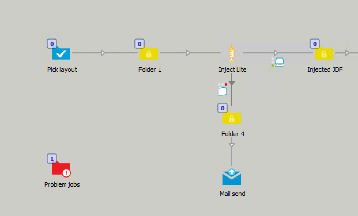

Gabriel, I am using Assert exist to check if file exist or not.
If file exist, everything is ok, however if the file does not exist, it fails and goes into "Problem Job" folder.
I have Error out connection to go to email, but it does not.
I can make workaround and take it from Problem job folder, however I am not sure if I did something wrong or if there is a bug.
This is log Debug or not it is same:
----7-08-31 16:53:58
error
Inject Lite
Pick layout
Inject Lite
00PUZ
CTP Replacement in STL.xlsx
Job '_00PUZ_CTP Replacement in STL.xlsx' was moved from folder 'E:/Enfocus App Data/backing/Pick layout/automanaged/Folder 1' to the problem jobs folder. Reason: see previous log message(s)
2017-08-31 16:53:58
error
Inject Lite
Pick layout
Inject Lite
00PUZ
Dynamic property 'JobPath' has invalid value '//ptr1/PTDATA/Impositions/8.375x10.875_PB1_HH.250_35.00x22.75_001_036pg_RO16X4RO4RO8RO16.jdf'
Screen Shot 2017-08-31 at 5.00.55 PM.png (154.27 KiB) Viewed 31341 times
gabrielp
Posts: 645
Location: Boston
Re: switch-inject-lite
Post by gabrielp »
Zoranj wrote:Dynamic property 'JobPath' has invalid value
Try this version of the script: https://github.com/open-automation/swit ... -validator
Someone at Enfocus is working on an appstore fix for this.
Zoranj
Posts: 107
Location: Canada
Post by Zoranj »
Script works as advertised, thanks
