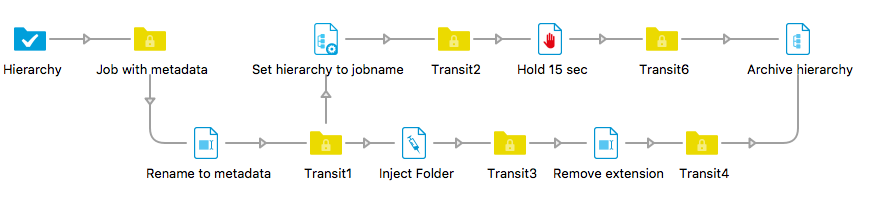

No, I still haven't found a way to use variables in the folder path.
However, I think your challenge is a bit different as you have the metadata to name the folder from. If I understand you correct, I think this can be solved by using the Inject Job element.
Create a folder containing the desired folder structure. Eg. a folder called "Topfolder" containing Folder_1, Folder_2 etc. and maybe some subfolders. Rename the incoming file using the metadata. Now use a copy of this file to trigger the injection of the folder containing the folder structure. When injecting the folder make sure to rename it after the incoming job (If that job has an extension, you will end up with a folder with an extension, which you have to remove using Rename Job).
On the original file (the one you didn't use for the injection) set the Hierarchy Path to be the Jobname Proper. Now direct both files to an Archive Hierarchy. You need to make sure that the new folder structure is in the Archiver Hierarchy before the file comes in. I suggest you simply put the file on hold for a few seconds to ensure that. There might be better ways?
It could all look something like this: As always with Switch there are probably other ways to achieve the same

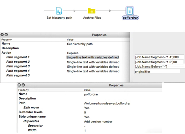

Hi Terkelsen.
Could this work?
In the set Set hieararchy path you set the number of subfolders you need, the first one based on the Customer name and then in the Archive hierarchy you set the path to the folder before your customer folder.
See attached screenshot where the path set in Archive points to //Volumes/huvudserver/poffordrar (basically the folder in which your customer folders reside).
In the Set hierarchy path I then use the file name to create the next three folder levels and then finally I have a specific folder name for the original files submitted for the job.
In your case Path segment 1 would be where you put the customer name.
Could this work?
- Hieararchy.jpg (125.71 KiB) Viewed 21852 times
Re: Using variables in filepath
@Terkelsen
You rock! It works and you elevated my knowledge a ton in figuring it all out!
Thank you,
Sam
Thank you,
Sam
