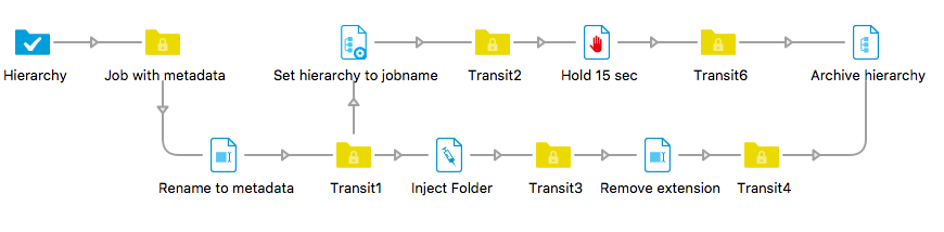

However, I think your challenge is a bit different as you have the metadata to name the folder from. If I understand you correct, I think this can be solved by using the Inject Job element.
Create a folder containing the desired folder structure. Eg. a folder called "Topfolder" containing Folder_1, Folder_2 etc. and maybe some subfolders. Rename the incoming file using the metadata. Now use a copy of this file to trigger the injection of the folder containing the folder structure. When injecting the folder make sure to rename it after the incoming job (If that job has an extension, you will end up with a folder with an extension, which you have to remove using Rename Job).
On the original file (the one you didn't use for the injection) set the Hierarchy Path to be the Jobname Proper. Now direct both files to an Archive Hierarchy. You need to make sure that the new folder structure is in the Archiver Hierarchy before the file comes in. I suggest you simply put the file on hold for a few seconds to ensure that. There might be better ways?
It could all look something like this:
Skærmbillede 2018-09-26 kl. 12.13.19.png (37.85 KiB) Viewed 21916 times
As always with Switch there are probably other ways to achieve the same ;)
