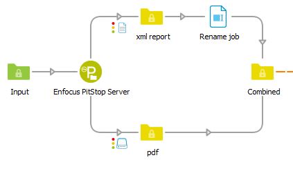

1.) the stop light connection wouldn't work with "data with log" selected, I would only receive back the pdf. So I ended up making 2 folders with 1 allowing "log" and the other allowing "data" to pass and then combined them back into the same folder. Is this normal?

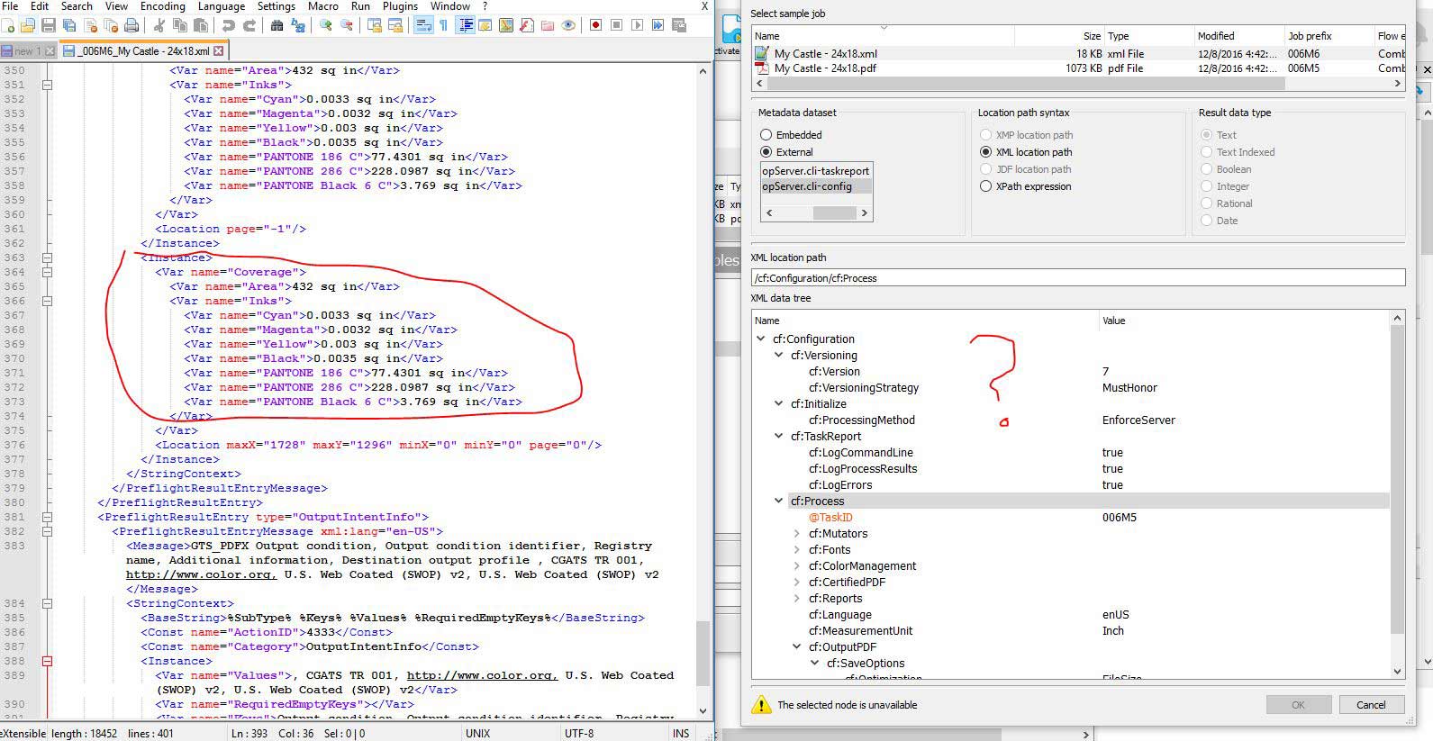

2.) this gave me the report in XML format. When opening the raw XML in a text editor all the data i need is there. However, when drilling into "build location path" in switch, the data that i need isn't in the XML, it displays other data. See attached screenshot.
3.) I was trying to use the XML pickup element and no matter which option i select, it goes into problem jobs. I don't know if its because of the difference in question #2?

There is a common misunderstanding that "Data with Log" creates 2 files in the output folder. It creates 1 file in the output folder and the Log part is attached as a dataset (in other words as metadata).
So if you use "Data with Log" as output from PitStop Server and the report is an XML file it is automatically attached as an XML dataset. If the report is a PDF, then it is also a attached as a dataset, but the obviously as an opaque dataset.
For those who need both a PDF report and an XML report: the PitStop Server configurator has a property to create an "Additional XML report dataset name".
