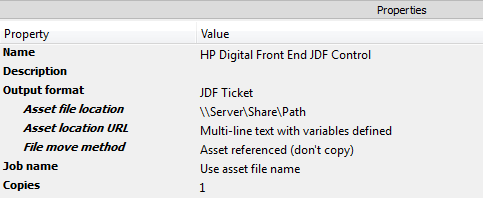

Regarding the other issues. I'm basing my responses on this simple XML file:
If you're pulling a file URL from the XML file you need to set up an XML pickup where "Metadata is asset" then set the configurator properties up like this:

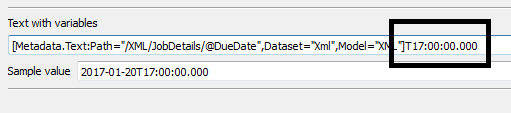

JDF requires an ISO 8601 timestamp format (YYYY-MM-DDThh:mm:ss.sss)
You can probably resolve the date issue by setting the Due date to "Select from calendar", then setting the Due date to "Single-line text with variables defined" and adding an extension "T17:00:00.000" (or whatever time of day you want jobs to be due) after your variable like this:

</XML>- "Asset file location" is only used when the asset file is the input to the configurator, so you can set that to any value
- "Asset location URL" needs to be the metadata path to the URL in the XML file.
- "File move method" should be set to "Asset referenced (don't copy) so the configurator doesn't try to copy the file from the location defined in "Asset file location"

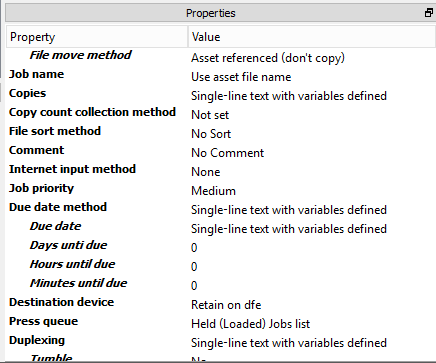

Re: Errors With HP Digital Front End JDF Control
Are you putting that value in the "Select from calendar" field?
Can you post a picture of your configurator settings in this area?
Also, what version of the configurator are you running?

The v10 release of the Configurator I have doesn't allow "Single-line text with variables defined" as a setting for Due date method. I'm wondering if this is part of the issue. Can you set that to "Select from calendar" as shown below?
I'm also concerned that the configurator didn't get updated to version 10 properly since this setting is not constrained. Version 10 is only available for Switch 13 and later. Are you possibly running 12r3 or earlier?

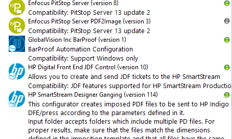

Switch v13 update 1.
The configuration did behave strangely, when I selected "Single-line text with variables defined" from the "Due date method" menu, it gave me the dialog to set it up as expected, then it put "Single-line text with variables defined" in the "Due-date" field too. See screen shot for configurator version info.
