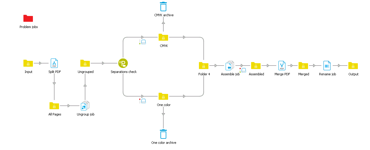

Hello.
I have problem with rename PDF file in my flow.
My flow checking every page of pdf document.
1) If all documents pages has only CMYK colors, final pdf file should has prefix CMYK_Job_name.pdf
2) If all documents pages has only one color, final pdf file should has prefix 1color_Job_name.pdf
3) If documents has both CMYK colors and one color pages, final pdf should has prefix MIX_Job_name.pdf
I don’t have scripting and metadata modules.
How can I rename pdf in my flow?

Maiby you can add a pitstop server between the folders "one color" and "Folder 4" to add a test to count the number of color ?

You can use the two rename configurator one is use after the CMYK Pdf Sepration folder and another is use one color Pdf sepration folder.
and set the properties.
