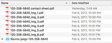

Files Structure.jpg (72.67 KiB) Viewed 8606 times
The current flow separates the incoming jpegs into the Source jpegs XXX-XXX-XXXX folder. Then resizes them to 7.85 x 7.85", adds a 1mm inset bounding box, and saves them as a PhotoShop PDF. The contact sheet in the attached image had to be created manually.

I know the SmartStream Designer Ganging configurator can take a folder of PDF files that are all the same size and gang them based on a selected imposition template (you might need to remove the Source jpegs folder first), but it might be easier to use the Assemble job step to create one large PDF containing all the images, and use one of the imposition configurators in Switch to do the 2x3 layout.
Is the text under each image already added, or do you need that done dynamically? If it needs to be added it would be easier to add it to each file before imposing IMO.
