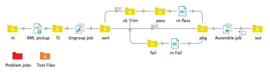

I just tried to post a lengthy reply and was punished by a timeout. Lost my wall of text. So, see attached flow.
Drop in a folder which contains the PDF and XML. The flow adds a pass_ or fail_ prefix to the file name.
Check PDF Trim.sflow.zip
(18.66 KiB) Downloaded 1519 times
