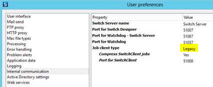

You can still use the SwitchClient of version 13 with Switch 2017: set Preferences - Internal communication - Job client type to Legacy.

Thank you for answer. But I have a Legacy format

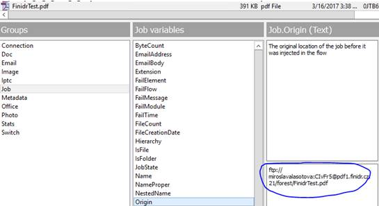

I can see the value “Origin” in the “Define single-line text with variables”. But script doesn’t work.

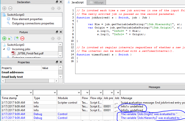

This is the javascript:
var Hie = job.getVariableAsString("[Job.Hierarchy]", s);
var Origin = job.getVariableAsString("[Job.Origin]", s);
s.log(1, "Info0= " + Hie);
s.log(1, "Info1= " + Origin);

For better imagination

That is in Switch Scripter!? Of course [Job.Origin] is not filled in. [Job.Origin] can only be filled in in a flow. Try the script again by running it in a flow with a file actually coming from an FTP site!
There are lots of properties that get added to a job as it travels through a flow. Because in Scripter the job is not traveling through a flow these properties are not available by default, but you can add metadata, private data, hierarchy and other stuff yourself. Unfortunately for you you cannot add the job's origin.
This being said, I do not know what it is exactly you want to do with the job's origin, but can't you obtain the same result using the job's hierarchy info? And that is a piece of info that you can add in Scripter while testing. In case you do not know how to add that: click on the script name in the Fixture pane and in the Properties pane you will see properties where you can define the metadata, private data, hierarchy, ... of a job.
