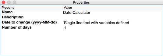

I have now made an app that is called Date Calculator. It will hopefully be on the Enfocus Appstore at the end of the week. And it will be FREE!
You can with it add or subtract days from a given date. and it will do it correctly over a change of months.

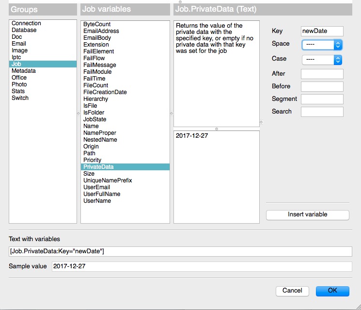

The new date will be stored as Private data in the job, you will also get Private data for Year, Month and Day so you can play around with the dates and format for your display of the date. It will only work with dates in the format 2017-06-18.
Date Calculator properties.jpg (23.52 KiB) Viewed 25468 times
Private data variable.jpg (90.08 KiB) Viewed 25468 times
