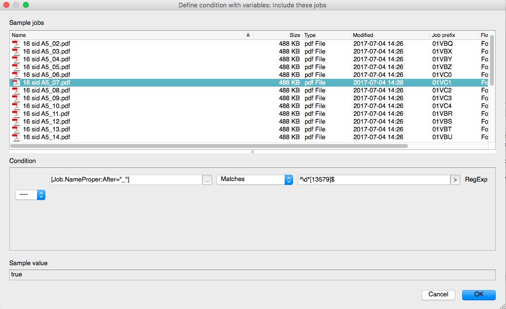

You can solve this without scripting too.
I guess you want to sort even or odd pages from a PDF and do different things with them.
If you first split the PDF in Switch and UnGroup the folder the pages end up in you have files with a suffix of the page numbers.
On the connection out of the folder you have a condition [Job.NameProper:After="_"] that Matches ^\d*[13579]$
For even values you change to ^\d*[02468]$
Screenshot 2017-07-04 14.46.44.jpg (133.52 KiB) Viewed 10081 times
Jan Suhr

Chrissigge
Posts: 20
Joined: Mon Jun 01, 2015 8:05 am
Location: Switzerland
Re: Script expression - If - Else
Post by Chrissigge »
jan_suhr wrote:You can solve this without scripting too.
Hi Jan, that solution was not possible in this case, Im using a third party configurator and the only way is here to work with script expressions.
But thank you for your help. :)
