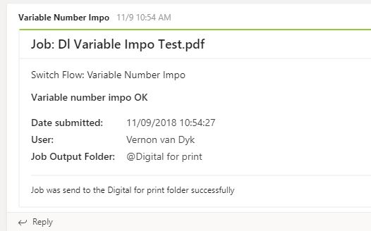

vernonvd
Posts: 45
Re: web hooks? MS Teams
Post by vernonvd »
we use MS teams via Switch. i was able to achieve this without scripting and it works quite well. i use the make json App
sample post:
