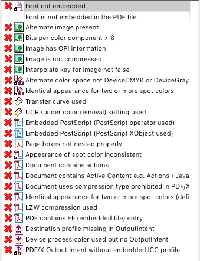

I'll link the rough list of errors I'm trying to test for. The end game being a Fixup set that can resolve any off these flags. But to be able to show that they work, or rather, work in a predictable way that can be shown and guaranteed to clients I've got to make a .PDF that won't pass. Some of it is simple enough; Actions / Forms / Profiles and so on but as you say, creating ones like the original two in the big Adobe three seems impossible :|
P.s This list is not finalised and as such repeats some of the same points but in slightly differing ways etc.
