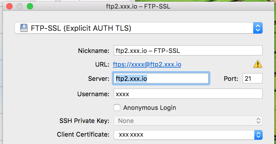

Hello,
I would like to download files from a "FTP-SSL AUTH-TLS" (see screenshot).
However I don't how to do that within Switch, could you please explain to me what I need to do - connection have to use a certificate.

Search the forums for "ftps". AFAIK, Switch supports sftp but not ftps, but others have pointed out workarounds.

I do this with WinSCP.
Example batch, but can be done with PowerShell too;
@echo off
"d:\Scripts\WinSCP\WinSCP.com" ^
  /log="D:\Flows\Incoming\ftps.log" /ini=nul ^
  /command ^
    "open ftps://username:password@ftps.lorem.com" ^
    "get -delete /TESTNAVOUT/* D:\Flows\Incoming\xml\ -filemask=*.xml" ^
    "synchronize local D:\Flows\Incoming\pdf /TFB/TESTARTWORK/ -filemask=*.pdf" ^
    "synchronize local D:\Flows\Incoming\jpg /TFB/TESTARTWORK/ -filemask=*.jpg" ^
    "exit"
set WINSCP_RESULT=%ERRORLEVEL%
if %WINSCP_RESULT% equ 0 (
  echo Success
) else (
  echo Error
exit /b %WINSCP_RESULT%
