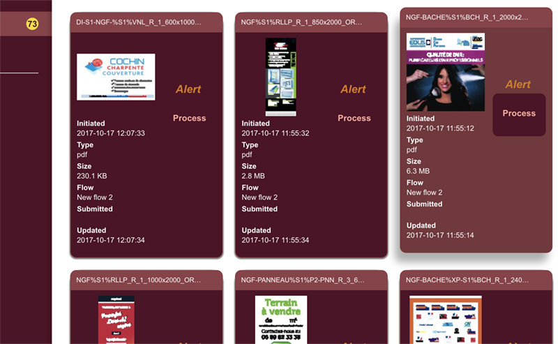

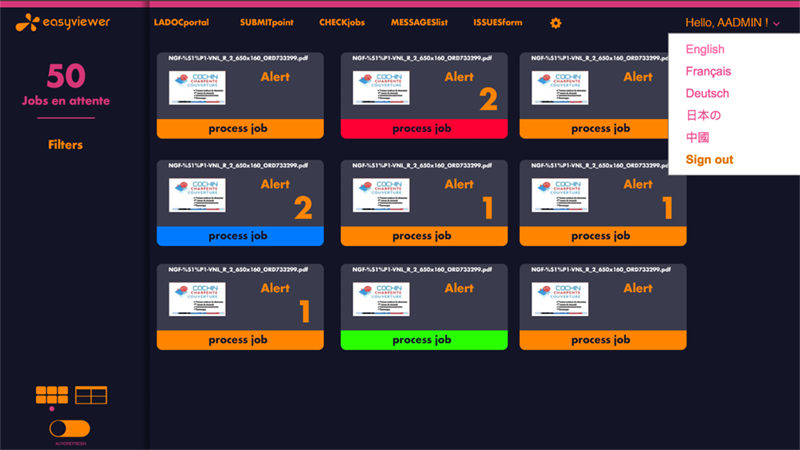

Re: Switch Portal, customization?
Post by victor Lukenga »
Hi,you can do it by manipulating the CSS which is simple see the pic attached
the option will to link a custom CSS sheet in the index.html and find what you can tweak;
Build your own Web Portal is a solution but we will have to get our brains stronger than ever :D
(hint : put "!important" when classes don't seems to change)
if you are not familiar with CSS here an exemple
.thisClassYouWantToManipulate{
	background-color:red!important;
	border-radius:5px!important;
hope it will help.

Nice one Victor ! I really like your tweak.
Great to know it's feasible somehow ;)
