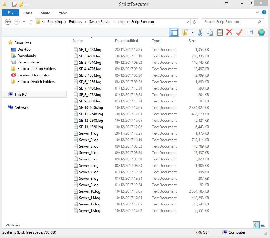

Today I found almost 10gb of logs in the following location:
C:\Users\Workflow\AppData\Roaming\Enfocus\Switch Server\logs
Switch preferences for logging are set for CSV files to be output to "C:/Users/Workflow/Documents/Switch Debug Log"
So what are the logs under the first path, which are regular text files and some are few hundred megabytes big, totalling almost 9GB !!!
There is also ServerLogs.db3 which is almost 10gb. What database is this and what data does it hold ?
Also it looks like those files are gaining weight incrementally, so are constantly in use and getting bigger, but are not purged or cleared.

The thing is these are not CSV files.
They are regular Text files.
See attached picture.
Not so old though, but still concerning...

I believe those are only created when debug logging is enabled. But since they are so big it might be best to contact Enfocus Support about them.
