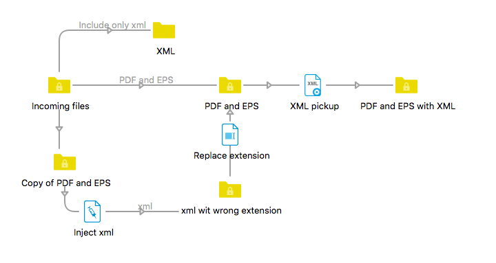

When you receive the files send the xml-files to a specific folder (not auto managed). Pass the PDF and EPS files to another folder. At the same time send a copy of the files to an Inject Job element. Set the Inject Job to inject the xml from the specified folder and use the part of the filename before the dash as a variable to specify the name of the xml to be injected.
Let the injected job be named after the incoming job. That will give you an xml with the correct job name but a wrong extension, so you will need to rename the extension to .xml using the rename tool.
This way you will end up with a folder containing all the PDF and EPS files AND an xml for each of them named after each of the PDF or EPS files. Then you can just use XML pickup as always.
