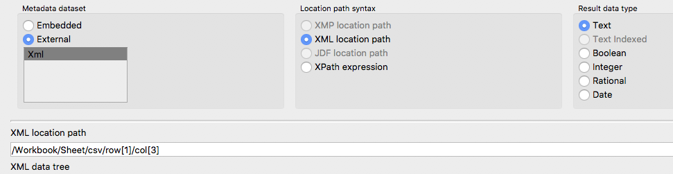

I converted an excel to an xml and trying to build a metadata path xml or xpath to extract information using all the rows associated with a column. The issue I'm having is I need some kind of variable or expression to use for the different rows, while the column stays constant at 3.

What is the XML structure exactly. What's best with XPath is not to use index but filters that will spot the interesting elements like:
//*[@id=123]
This would return any element WHERE id attribute equals 123 whatever its location inside the structure.
Could this be applied in your case ?
Loic
//*[@id=123]
Loic
Re: Extracting metadata from an excel
Not to hijack the thread, but might be helpful for GIlmore as well, Loic how would you pick with Xpath all "Impressions" from this XML:

@zoranj
The value of "Impressions in a specific Node
/Log/SQLStatementValue/Row[3]/Column[5][@Name="Impressions"]
A list of all of the values
[Metadata.TextIndexed:Path="/Log/SQLStatementValue/Row/Column[@Name='Impressions']",Dataset="Xml",Model="XML"]
A sum of the values
[Metadata.Integer:Path="sum(/Log/SQLStatementValue/Row/Column[@Name='Impressions'])",Dataset="Xml",Model="XML"]
Hopefully this helps GiIlmore too.
Thanks, this is great help.
THANK YOU, THANK YOU, THANK YOU.allsystems wrote:@zoranj
A sum of the values
I finally understand where I kept making a mistake defining XPath and it never worked, so I had to go with index as Switch automaticaly sugests
All the flows now amended to look for the XPath value predicates /col[@name='blablabla']
Sometimes the easiest and most straightforward things hapen to be the most difficult...
